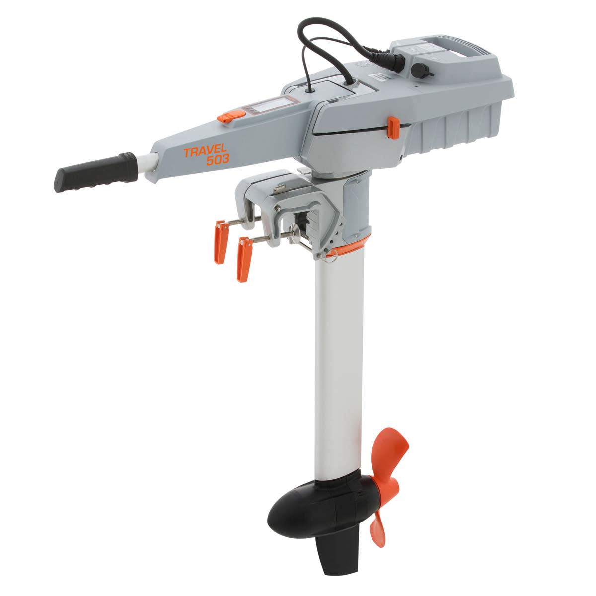

We have thought about adding a Torquedo electric motor.  Unlike the trolling motor this has the battery pack as part of the motor which btw can be solar charged.  They are fairly lightweight.

   Oceanluvr, That video is a great help; shows it will move the boat well and that perhaps the support should be further forward than I was thinking. The Torquedo is quite pricey at around two grand but having the battery self contained is a plus.
